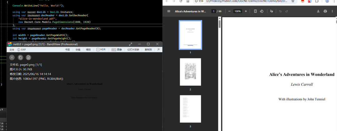

2. 渲染 PDF 页面为图像
using Docnet.Core;
using var docLib = DocLib.Instance;
using var docReader = docLib.GetDocReader(
    "alice-in-wonderland.pdf",
    new Docnet.Core.Models.PageDimensions(10801920)
using var pageReader = docReader.GetPageReader(0);
int width = pageReader.GetPageWidth();
int height = pageReader.GetPageHeight();
var rawBytes = pageReader.GetImage();
