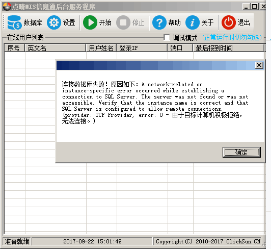

点晴信息通后台服务程序每次开机重启动都会报错,如何解决?
A network-related or instance-specific error occurred while establishing a connection to SQL Server. The server was not found or was not accessible. Verify that the instance name is correct and that SQL Server is configured to allow remote connections. (provider: TCP provider, error: 0 - 由于目标计算机积极拒绝,无法连接。)
出现以上错误的原因是系统开机启动时,点晴MIS信息通后台服务程序加载速度快过SQL Server数据库,导致数据库还没有启动就去连接,从而出现连接失败的问题。
